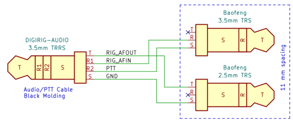

Digirig 1.6 and newer revisions have the audio and PTT permanently available on the audio socket independently from the serial port. The CAT configuration is not required and the interface in any CAT configuration can be used with the HTs. This makes it simple to interface basic handhelds and mobile transceivers via a single connection while keeping advanced rig control options available for more capable equipment.
Premade Digirig 1.6+ cables are available for popular HTs featuring K1 connector (Baofeng, Kenwood etc.) as well as cables for radios using a single 3.5mm TRRS connector (e.g. many Yaesu HTs) and other types of dual connectors (FT-65R, Icom HTs).
By default Digirig 1.5 is configured to communicate with a CAT-capable radio over the serial interface. Using the solder jumper on the back of the PCB, the interface can be configured to trigger the PTT line using the RTS signal of its serial interface.
To switch Digirig to hardware PTT, carefully cut the trace connecting the central pad to the TXD pad. Make sure to contain the cut strictly between the pads because there are traces nearby that can be unintentionally damaged. Use a continuity tester to verify the pads are no longer connected. Bridge the central pad to the RTS pad using the ball of solder as shown above. This connects the RTS controlled PTT driver circuitry to the tip of the 3.5mm socket labeled “SERIAL”.
The easiest option for making a cable is to cannibalize an inexpensive external wired mic/speaker accessory and add 3.5mm TRS connectors on the Digirig side.
